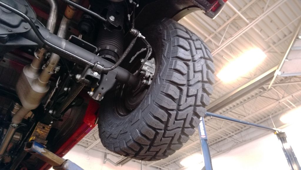

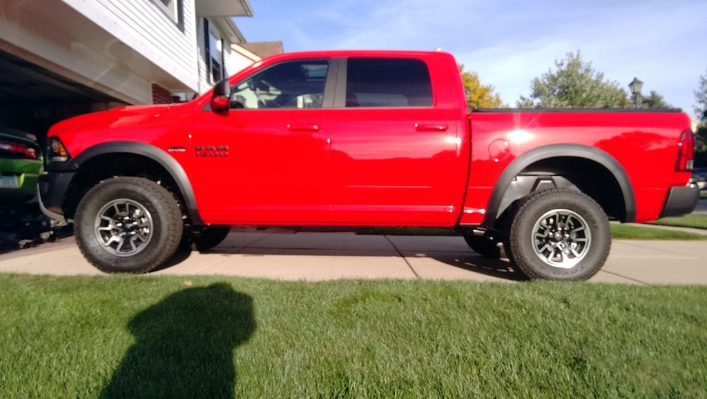

After much speculation, I've successfully mounted a set of Toyo R/T 35-12.5 R17 LT Tires on stock 2016 Rebel without any rubbing issues, lift kit or level kit. The Toyo R/T is a new compound that is an upgrade over the stock Toyo A/T. It was just released a couple months ago & it's an aggressive looking tire that doesn't give you the hassles of an M/T offroad's noise, unbalance & fast tread wear.
A simple, easy & inexpensive mod to the Rebel Air ride system will be required to do the 35" tire swap. More details are in this thread:
http://www.ramrebelforum.com/forum/appearance-body/2657-body-lifts.html
No suspension component contact & plenty of travel
Close in the rear of driver side front on a full lock turn to the right, but nothing of concern as it's only plastic liner that, worst case scenario can be heated with heat gun & massaged back.
Drives & steers like stock, these tires are better than the stock A/T's IMO

one of my favorite upgrades done so far on this forum has to be the tire set Roomraider upgraded to:
Can't get enough of how it looks from this angle:
