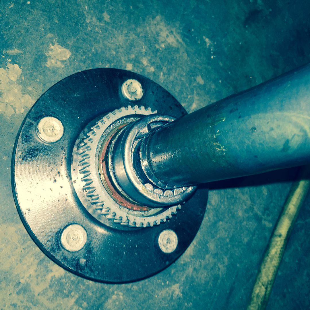

i guess it was a bad bearing, messed up the axel seal, and the shaft and some other stuffs..
Incorrect torque from the axle supplier?
bearing blew and shredded my axle shaft
See less See more
rear axle bearing
2000 miles and I took it into the dealer today. Rear axle bearing assembly blown. Parts are on back order. Should be in at the dealer in 5-7 business days. I did get a Ram truck as a courtesy vehicle.
